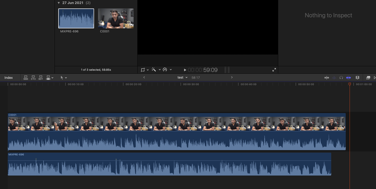

I record videos in Movie Mode but I record my Audio using an external recorder/mic and sync up the audio and video files in Post. This has worked for years, until now.
I noticed that my video files recorded by my Sony plays back a bit slower in some part of the video, inconsistently throughout the entire clip. I noticed because my audio files I recorded to my SoundDevices Recorder is not in sync with the audio recorded by the camera.
In the screenshot below, you can see the audio that's recorded from my camera with the video clip, and below it, the actual audio from my sound recorder. And you can see the difference in the timeline length for each (they should be the same).
Timeline Screenshot

I actually found out why it was doing this. I was recording in 4K 25p, but my project file in FCPX was defaulting to 4K 23.98p after I had updated the app, and didn't catch that when creating new project files. So it was the framerate difference that was causing it!
