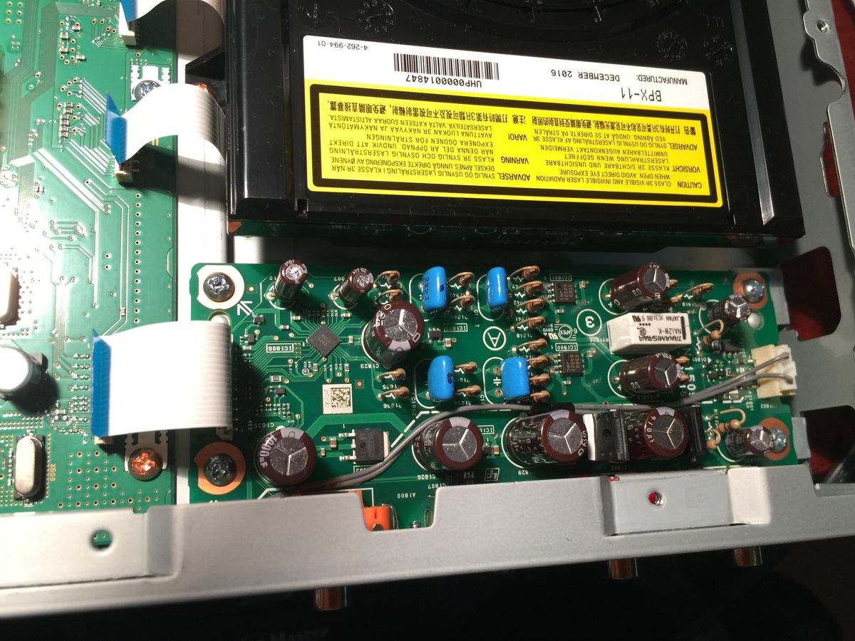

Regarding UHP-H1 blueray HiRes universal player I can say that the analog output seems that not offer the "premium" sound that is expected to be. In orher hand I found on the internet some photos taken from inside of this player and seems that DAC is AKM4452 ... that should offer be a "velvet sound", but it`s actually NOT (https://www.akm.com/akm/en/product/datasheet1/?partno=AK4452VN) .

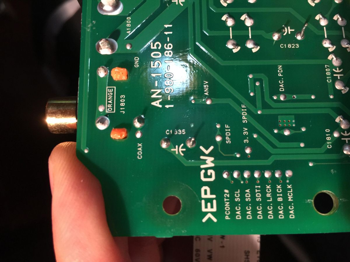

In the meantime I found a way to extractor DSD stream from HDMI cable and  output it in a I2S signal, then apply it to the input of I2S/DSD sample rate convertor based on Ak4137 which was set to upsampling any PCM/DSD input directly to DSD256 (11.4 Mhz) .
At the end a DAC based on  ES9038Q2M (with I2S input) and then "briliant sound" experience.
