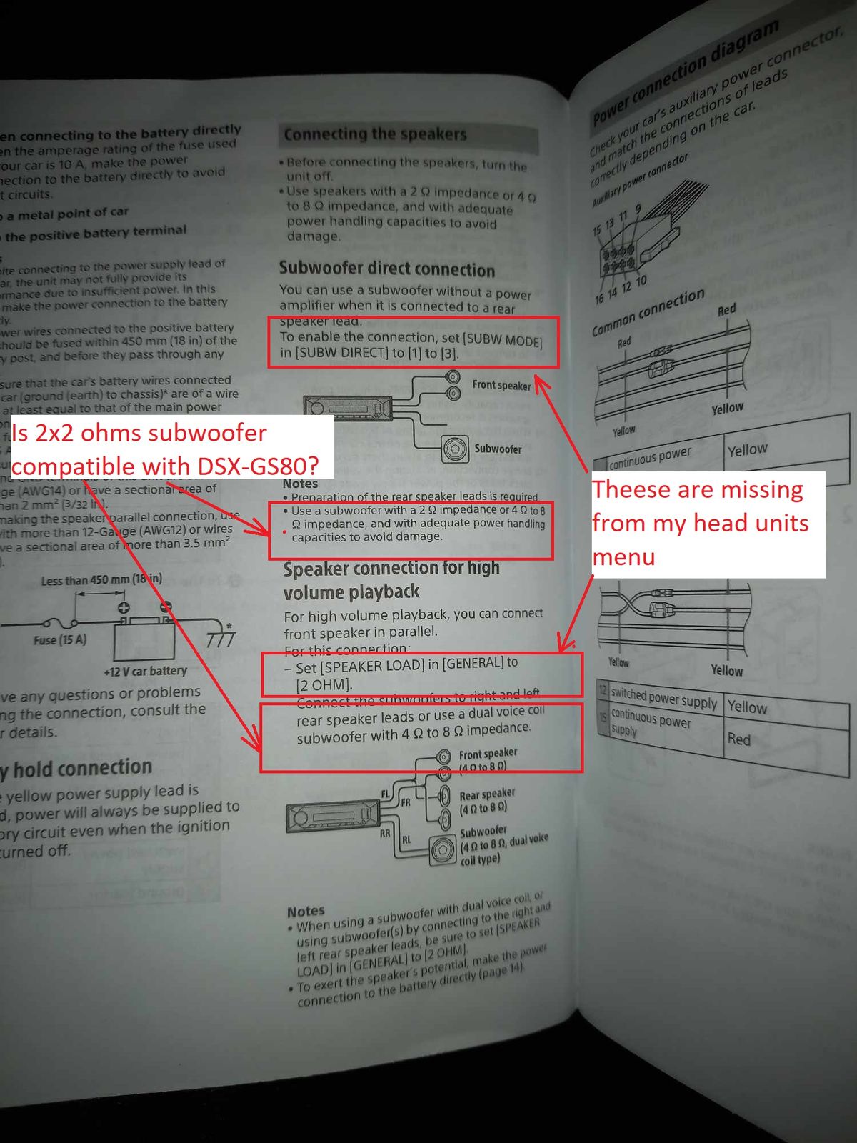

Dear Sony Community,
Recently I have bought a head unit type DSX-GS80. The reason why I chose this product because - according to the user manual, which is available through the Sony website - it is capable to drive a subwoofer directly. According to the user manual, I installed the new head unit to the car. I looked at the menu options but I sadly saw that in the [GENERAL] group, there is no [SPEAKER LOAD] option, so I can't set the speaker load to 2 ohms. (Operating Instrucions page 14) In the Menu,there is no [SUBW MODE] and [SUBW DIRECT] options, so I cant do the settings listed in the Operating Instrucions page 14. My subwoofer has a double voice coiled type speaker, which has 2 ohms of impedance of each coil.
My questions are:
- Is my subwoofer compatible with the DSX-GS80 in 2x2 ohms configuration? (I can imagine that it is compatible in 1x4 ohm configuration, but I would like to use it in 2x2 ohms setup because of the higher output power).
- How to setup the head unit to drive the subwoofer directly? (My guess is the Rear Bass Enhanche option)
- Do I have to update the firmware of the head unit? If I have to, where can I find the correct firmware file and how to update it?
- Do the DSX-GS80 have an overload protection?
I hope that Sony Community members would answer my question soon!
Thank you in advance!
Best regards,
József Orgován

SPEAKER LOAD (speaker impedance load)
(Available only while the source is off and the clock is displayed.)
https://helpguide.sony.net/ev/dsx-gs80/v1/en/contents/TP0002433778.html
Sound Setup (SOUND)
This setup menu is not available when the source is off and the clock is displayed.
https://helpguide.sony.net/ev/dsx-gs80/v1/en/contents/TP0002433779.html

A subwoofer with two 2 ohm coils each in a 2x2 ohm configuration could deliver more power than a subwoofer with a single 4 ohm coil. This is due to the possibility of connecting the coils in series or parallel to obtain different impedance configurations.
- In the case of the 2x2 ohm Subwoofer, connecting the two coils in Parallel would obtain an impedance of 1 ohm, while connecting them in Series would provide an impedance of 4 ohm.
- In the case of the 1x4 ohm Subwoofer, you will only have one impedance option, which is 4 ohm.
DSX-GS80 cannot handle 1 ohm impedance.

Hello,
Thanks for your answer.
My sub has 2 coils, 2 ohms each. I would like to use it as one coil would be connected to the rear left channel, and the other coil would be connected to the rear right channel. If I set the output impedance to 2 ohms, will it be OK?
The front speakers has 3 ohms impedance.
Thank you!

The important thing I would say is not to connect them in Series or Parallel...
