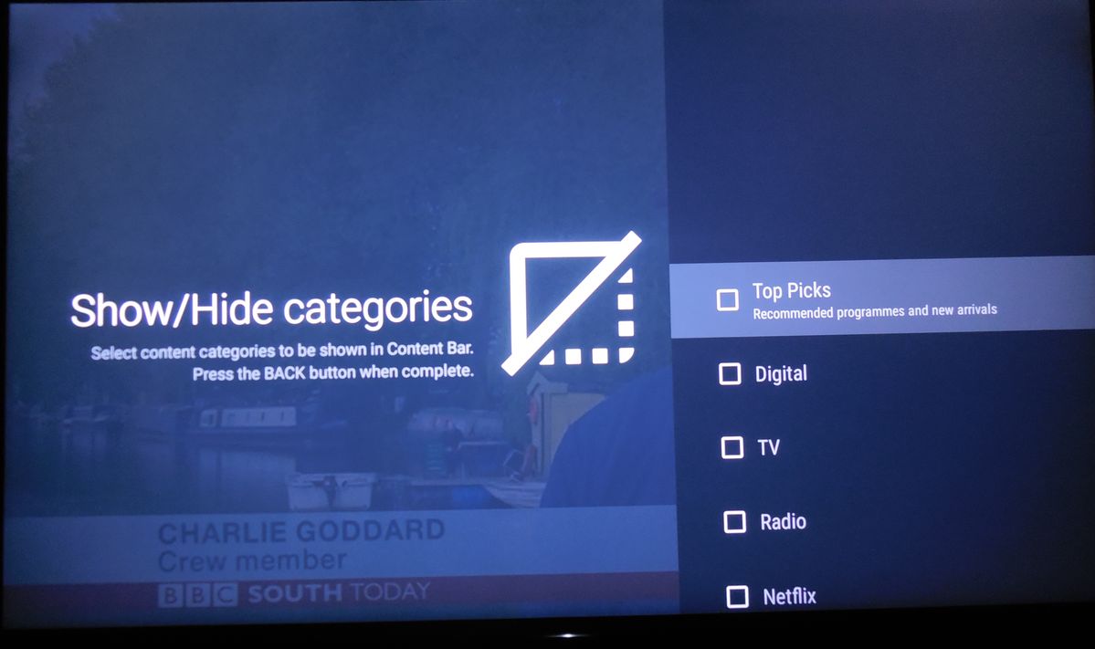

For @Flashlab2 :
This is the screen that I get when I first press the [Discover] button with all categories hidden:
These are the option categories that I can show/hide:
Have a look at the settings again - see if you have not missed one. If you are still having issues, ill escalate this thread to Sony Support.
