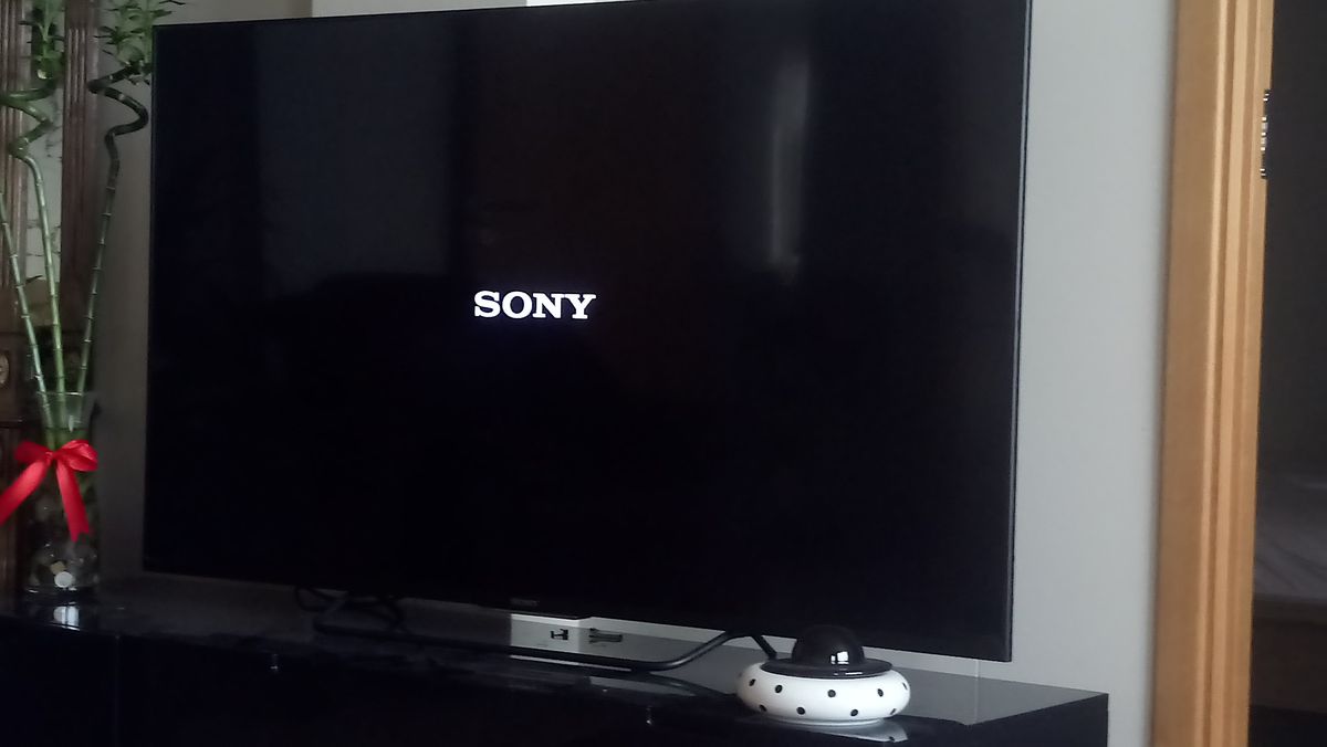

my TV sony kdl-55w755c stops working. when it is turned on, giving the Sony logo on the screen, freezing and the LED does not light up.I tried to unplug it for more than an hour by pulling the power cable and then pressing the volume down button with the power button for more than thirty seconds to work with Restart but to no avail.I also tried to download the recovery program from the site here and put it on usb flash drive and put it in the TV socket and followed the instructions but nothing has changed remains device gives Sony logo and freezes is there another way to try it?

I spoke with Sony support about this problem and tried all the methods that you mentioned and as a result the Sony support answer was that (if your device is out of warranty period go to the nearest repair center) did not benefit from their advice
Mainboard has fried since a firmware issue. Sony won’t accept fault...
What do you think they are doing? Did you know that I suffered from this problem a week ago and so far I have not found any site on the net to buy main board to my tv.

I contacted my local authorised Sony Repair Centre who confirmed that the Main Board was faulty. Unfortunately they were unable to replace it as no replacement parts were available.
I asked for an engineers report and returned to the retailer I purchased the television from and lucked out as the Store Manager used his discretion to offer me a replacement television set.
